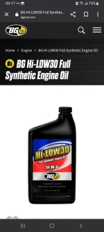

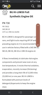

Interesting that a 0w30 from BG is suitable for recommended oem weights. I saw the very thing at Penrite with similar wording.
