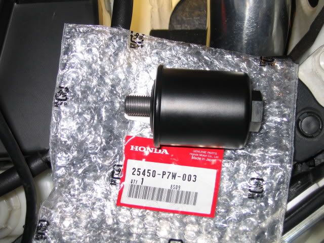

2003 Acura 3.2TL. The filter screws into the top of the transmission and has a line with an o-ring that bolts into the back of it. It was fairly easy to change.
Here is an image that hopefully shows a better view of where it is (it's number 9 in the diagram):

The factory spin-on for my sister's Acura auto trans seems to be a bit more than a rock catcher. I'd say it's worth changing.
Not sure if all of the Honda 5 speed autos had this though.
No, that is a real filter. The one I changed a couple of years ago only had a screen inside. I don't remember the year or model or even if the old filter was OE or aftermarket.

Wow they make external filters that are just screens? For some reason I thought you were referring to the internal filters which are usually just a screen, and agree that those should be left alone since they rarely catch anything and require quite a bit of work to access.
The internal ones on these units is not replaceable during normal service anyway.
I have seen a screw on that was just a screen inside, I can say if it was OE or not as it was in rough shape outside with no identifying marks or part# visible but seeing your cut open one I suspect it was made by whoflugdung in usa China.
