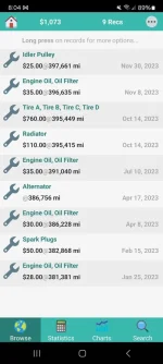

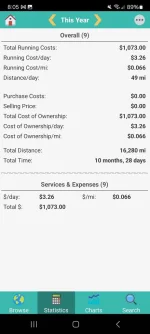

After getting my "beater" Civic baselined and replacing a few things to make it a better daily driver, I've only had to do oil changes. It is due for a timing belt and a local shop quoted me $800 to do it.
This year's expenses included--
Replaced front brake pads/rotors/calipers $250
Replaced driver's front door lock actuator $25
Oil change (I had the oil already) $5
For 2024, I anticipate only having to do the timing belt and another oil change. Insurance on the car is about $100 for 6 months and it costs a little more than $30 to fill the tank which usually lasts me 2-3 weeks.

99 GS400. No cost on the alternator as it was under warranty
