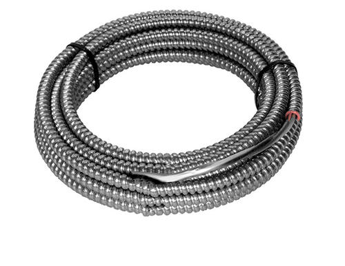

The MC usually comes with wire in it. Thought they called it BX.
http://www.menards.com/main/p-1444442903851-c-6441.htm?tid=-1913789389563123518
