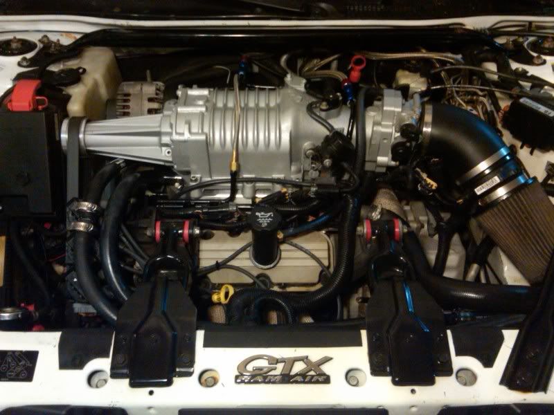

As a toy I have a 2001 Grand Prix GTP I built up the engine and was wondering if there is a specific oil and filter you would recommend. It is a 3.8L supercharged V6 with lots of modifications done to the engine, and the entire car. I beat the snot out of this thing, take it to the drag strip and run it hard all the time. I am currently running Pennzoil Platinum 5w30 and that is what the car calls for. I have also used Mobil 1 many of times and not had a problem with either yet. Here is the list of mods so you have a better idea.
2005 3800 V6
9.5 to 1 compression
2005 Eaton Gen V supercharger
14 psi of boost
ZZP XP cam shaft with .526 lift
Comp 105 lb valve springs
Modified spring retainers
ZZP stage 2 intercooler
ARP head studs
ARP rocker bolts
T.O.G. Extreme headers
3" exhaust
Dynotech race built transmission
DHP Powertuner and tuned by myself
and other small supporting mods
its a monster and will rip the tires loose at 60mph lol
