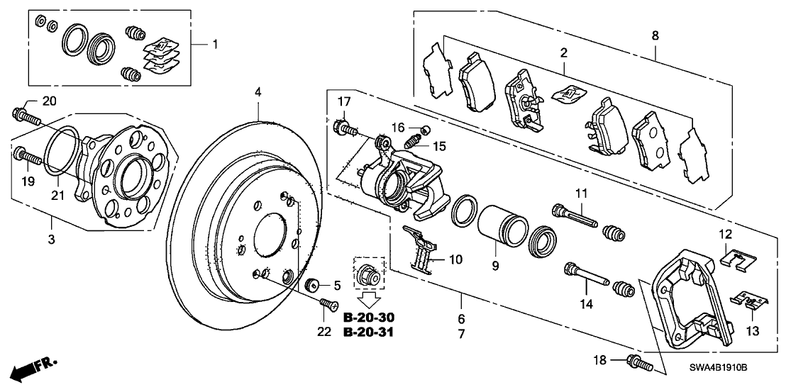

When I saw the picture, before reading your post, I knew it was a Honda. I believe it goes between the caliper and caliper bracket.
Not seeing it.
the one thing that bothers me (well 2 really) is that it looks too deliberately formed around the inner circumference. The other is that it was still there on that old of car.
Many makes use some sort of push nut on one of the studs to hold drums or rotors in place during assembly and that's what it looks like.
Hall may well be right though, but i don't see it in the diagrams.
Thank you very very much everyone, I was worried it was something from the emergency brake assembly.
I'd probably order four then see what is/is not there with parts in hand. Looks like they were ~$1 ea, but not sure if that was before Irrational Global Panic.
Did you remove the caliper/brake pad bracket?
Some models have two shims to properly line the bracket up with the rotor, my eye sight isn't the best these days but really it reminds me of this but if the bracket wasn't removed than it's not a possibility.
Yes. Wasn't aware they used spacers, have not seen one fall out before. I've probably had these brackets off 3 other times over the years. I always clean out the slide pin grease with q tips and brakekleen when I do pads or pads/rotors. The CRV has 181k on it. Owned it since it had just 15k.
Not sure if it's the braided stainless brake hoses or the rotor with the Akebono pads. The initial bite is aggressive. Leaps and bounds better than I was expecting.
Sorry misclicked something, I apologize I hadn't read the post I seen the shim, looked up and seen CRV. Felt very confident that is what it was should have read.
But yeah the shims tend to stick in place for the most part.
They do. The bent tabs tend to 'bite' and keep them in place. After 15+ years and if the bracket gets removed a few times, I've seen them loosen up enough that they fall out. I suppose you could try bending the tabs a bit but I just put a dab of Syl-Glyde between it to hold it like glue.
