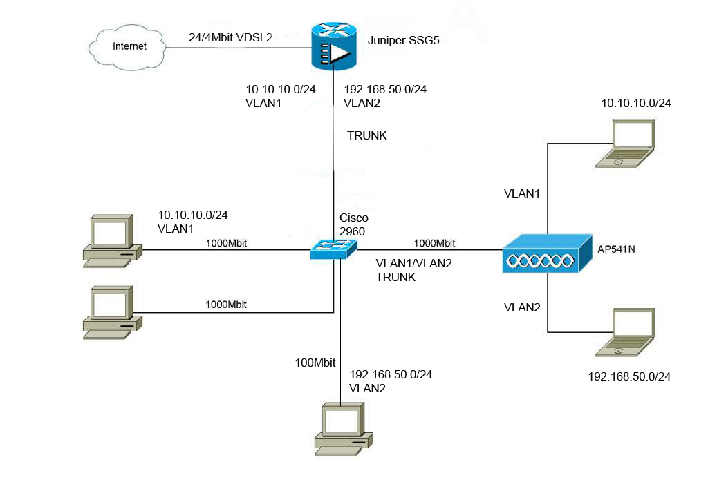

We recently had a "post your network setup" thread on here, so I'll post my picture from that thread to give you an idea of what you should be shooting for:
Just to add, the setup they depict doesn't include a VLAN aware firewall/router.
The firewall/router would be on the default VLAN, VLAN1.
The server and NAS are shown to have access to both VLAN's, the AP is isolated to VLAN2.
Unless the switch is Layer 3 (which, given the vagueness of Netgear's terminology, it may very well be) then it won't be routing between VLAN's. On the other hand, the topology they depict would work (properly) with an L3 switch, since it can handle the inter-vlan routing with the Internet connection on VLAN1.
Definitely not how I would design it, but then I'm a Cisco guy.

For this config I'd have a 1921 (or something similar) with VLAN1 and VLAN2. gi0/0 would be my WAN port, gi0/1 would be LAN and trunked.
Switch would be a 2960 (layer 2) with whatever ports you wanted to be private assigned as access ports in VLAN1.
Assuming a VLAN aware AP, it would be on a trunk port.
Assuming a non-VLAN aware AP and the clients are public, it would be on an access port assigned to VLAN2.
Both VLAN's would have their own DHCP pools (as indicated in my diagram) as they are on completely separate subnets.
You could have a bank of access ports assigned to VLAN2 as well, which would then be on the same subnet as the AP.
