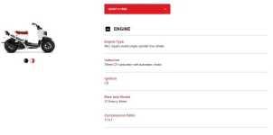

Yes it is a small 49CC engine, but being liquid-cooled and with frequent OCIs I don't exactly see how the "Resource Conserving" category would make a difference. Honda recommends 2500-mile OCI with the 0.6qt (~20oz) capacity. I do 500-700 mile OCIs though. Just because it has no oil filter (just a mesh screen), I'm a heavier rider than average, and CVT keeps this tiny "GET" engine at 7000-9000 RPM most of the time. (At >10k RPM these usually start floating the valves, and valve to piston interference happens.) What exactly about "Resource Conserving" scares Honda enough to include the cautionary statements in the owner's manual against it? School me please, legitimately just trying to learn here. This engine seems to be as close to a "normal" car engine as it gets, compared to its air-cooled rivals. Yet I haven't seen many cars caution against "Resource Conserving" oils, quite the opposite actually.
