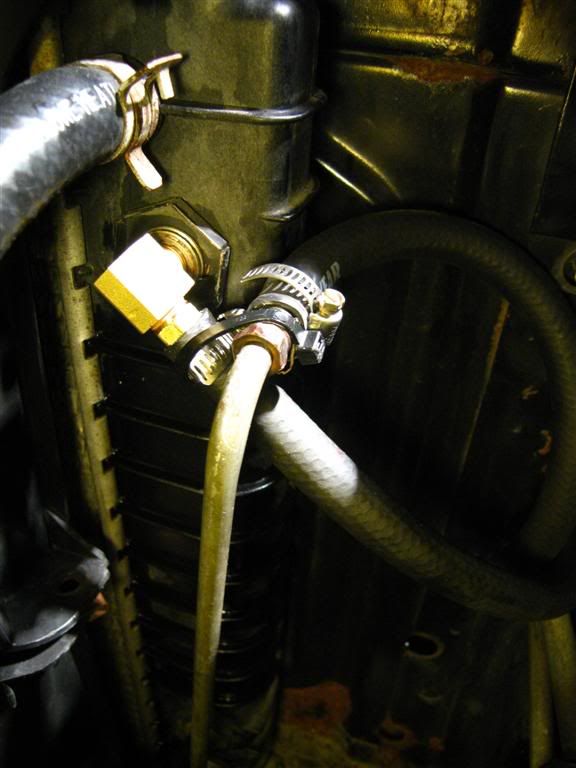

For 10 seconds and no cost, use a piece of cardboard over the fins of the aftermarket cooler when it's really cold.
To seal cut metal lines that you are going to attach rubber lines to, use two clamps on each end, 180 degrees rotated. You can also SLIGHTLY flare the tube ends where they were cut. Smooth any sharp edges in any case before assembly. Give enough line to let the engine move and rock.
