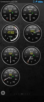

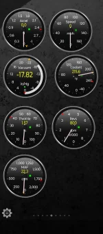

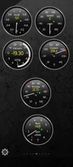

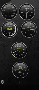

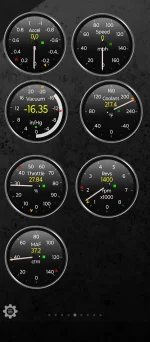

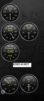

Can anyone of you all look at these screen shots from Torque Pro and see if you all can make any sense of any of them?
RPM TPS% Temp and MAF are shown. All RPM readings are with accelerator pedal at rest.
KOEO with accelerator pedal at rest TPS % was/ls 0.

Key on but engine not running, watch the TPS percent as you very slowly press the gas pedal from zero to full. It should increase smoothly. Any jumping around is a bad TPS.
Also wiggle the wires on the TPS while watching if the percent jumps, that could be a bad connection.
That part looks good!
Still need go do this.

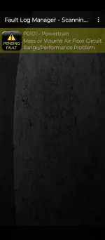

Changed the TPS still having Issues, and now a "pending" code PO101.
Can you please look at my screenshot's and see if you see anything out of order.
Also KOEO gas pedal at rest, TPS % is 0. KOEO gas pedal at WOT, TPS % is at 100 %.
