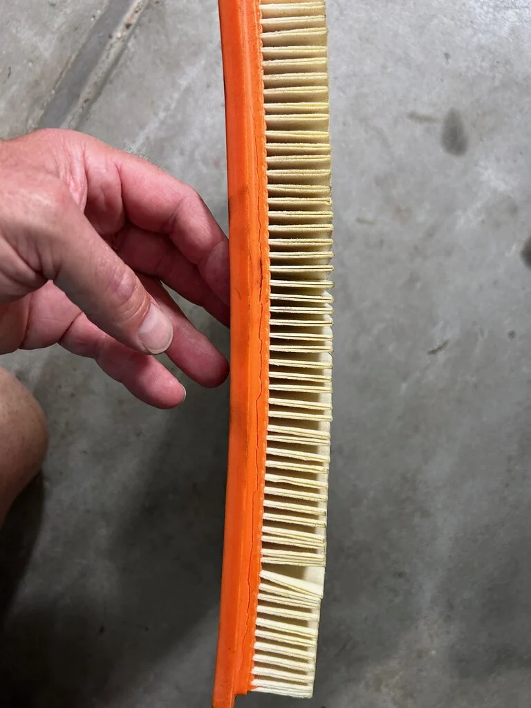

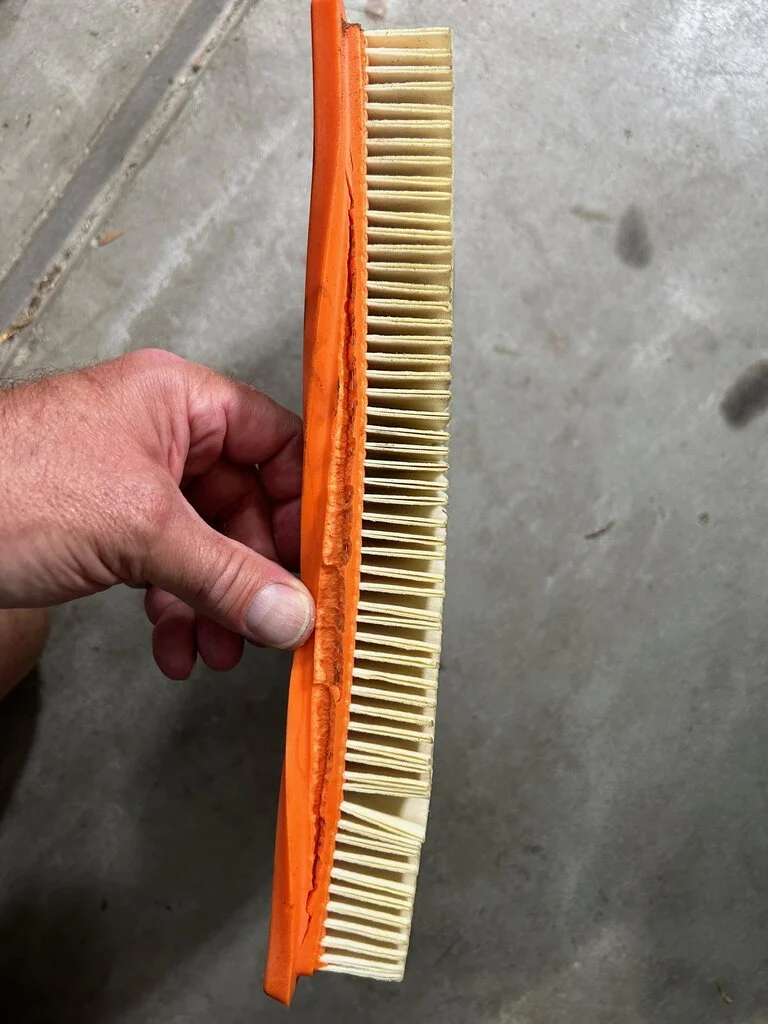

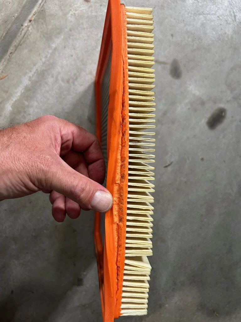

Pulled this air filter from service on inspection. Been installed only about 3000 miles. Its a Nissan branded Mahle. I know its Mahle because it matches the Mahle branded one what went back in, right down to the Jig marks from assembly.
What causes this? Defective gasket material?
It didn't fully split so no harm, but I pulled from service. I replaced with a Mahle filter I had on the shelf. I will check it soon also. I actually tried to replace it with a Denso filter, but the gasket was much more dense and very difficult to get the filter box closed. Since this car is driven by my daughter who is 100 miles away, I didn't want any issues in case someone else might open it some day. I will use that one in my truck next time.
Guess I am in search of a different brand again. I used nothing but Wix until they stopped with the metal mesh backing. This is the Mahle / OEM. Denso as mentioned is a little difficult to fit?
Curious of coo? Appears cracking at the point pleat ends. Bad foam mold process, bad foam composition, combination of the two. Yeah, I'd be looking for another brand/option.

Oils in the flexible, orange gasket volatilized. That process got lid and box to stick. It just pulled apart; I think.
Likely not as dire as first thought.

Probably the foam seal sticking to the filter housing as you took it out. Harmless, as the crack will close shut as you put it back and clamp down the lid on it.
So to satisfy my curiosity I tried pulling the other three sides apart - the split is only on that one side. No go - there not separating. I think the "it stuck" theory is unlikely.
I assume heat is part of the molding process? Maybe that side was too hot or not hot enough? I am pretty sure its a material issue.
As I was reading this post.. then saw your post.. It's exactly that, a manufacturing defect causing the seal to become brittle/weak and split. This whole "Race to the bottom" is getting ridiculous. And unless you have a materials engineering lab to test it out when new, no way to know it's going to happen over time.
I'd definitely avoid these filters for now.. looks like they need some help on the production line! some will say it happens, nothing's perfect.. that's true, but you can increase your success rate by not going back to that brand.. just wow.. maybe they'll fix it in the future, I wouldn't want to take the chance..
