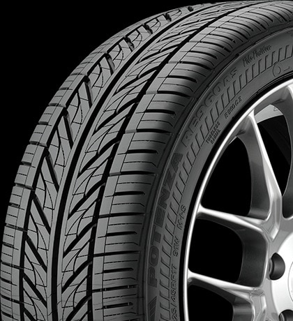

Depends. Many directional tires still have lengthwise channels that will still work when installed backwards. I've seen a few that dead-end, but that's fairly minor compared to the big channels. Something like a Bridgestone Potenza RE960AS.
[Linked Image]

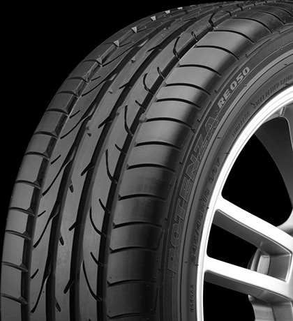

However, a Bridgestone Potenza RE050 is called directional, but it's not likely to affect water evacuation if reversed. It might affect the handling though. It's got tiny little dead ends in the tread design no worse than I've seen in non-directional tires or in asymmetric tires.
[Linked Image]
These are the tires I have mounted on my car right now. Two of the ribs dead end and in different directions. It could be a design more about handling than channeling water.
