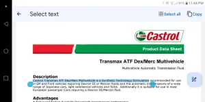

Was checking out Castrols Dex/Merc fluid and it says:
Castrol Transmax ATF Dex/Merc Multivehicle is a Synthetic Technology formulation ...... Does that mean it's a sythetic fluid? Blend? Conventional made the same way as synthetic?
Pardon my ignorance if the answer is obvious..... I'm still learning about all this stuff.

Not Ignorance. Oil can be complicated. From what I gather "Synthetic Technology" is essentially a fancy way of using only a small portion of a group III oil & the rest being Group II. Basically, not enough group III oil in the mixture to claim "Synthetic Blend". For transmissions a decent Full Synthetic fluid can give you piece of mind but not always necessary if you're going to change it out on schedule.

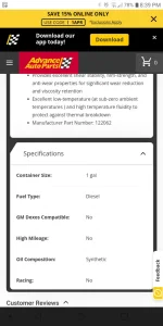

If you want a great synthetic Dex III compatible fluid look no further.

I've asked this question in the past. I notice Total use a lot of 'synthetic technology'. I now assume it just means it's a Group 3 oil.
Ok i see the delvac link. I thought he was talking about the castrol.
The manufacturer of the fluid says delvac isnt dexos compatible.

Dexos is a motor oil specification not transmission fluid, TES-295 Allison fluid is essentially a synthetic Dexron III fluid that was designed to be survive long drain intervals in heavy duty transmissions.
