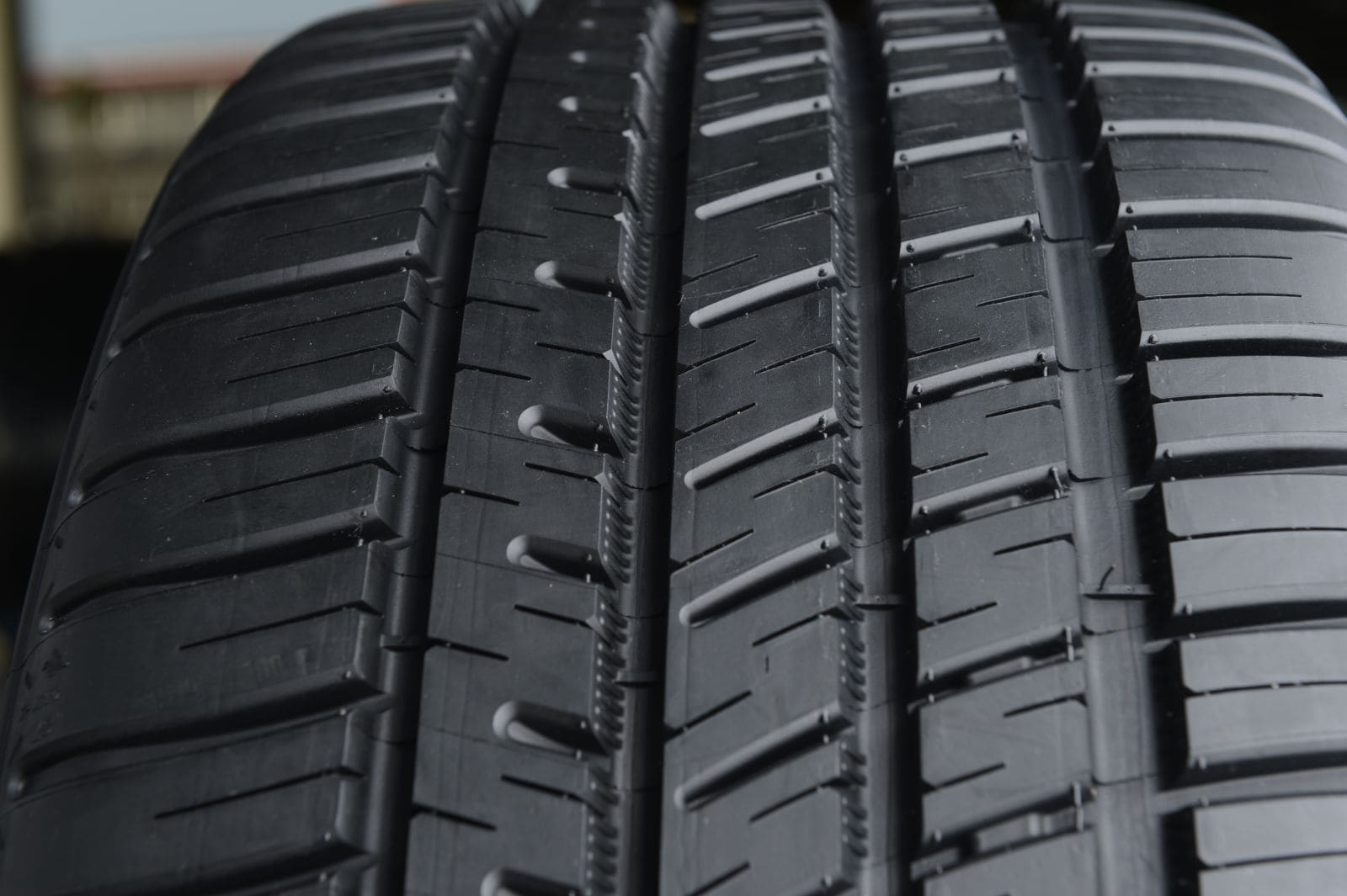

Here's a look at the second rib, looking at it from the outside edge. You can see the sipes aren't cut very deeply into the tread.

Yes, the sipes on the RT43 don't go to the edge of the tread blocks. I would love for anyone with the RT43s who have a significant number of miles on them if they could post a picture of the tread to see how it looks as it wears.

I'm not sure it decreases winter performance. It's probably meant to make the tread block less "squirmy", but still provide sipes when there's adequate tread for winter driving. When it gets down to that point, it's probably not appropriate for winter driving conditions.

I've noticed this on various tires as well. I would imagine not siping the full depth of the tread improves the stability/handling of the tire.

It is pretty common for sipes not to be full depth AND for individual sipes to be varying depths across their length. I've always assumed this was done for handling and wear purposes. I also assume this is done to prevent chunkouts due to gravel roads.
I don't know of any tire manufacturer who doesn't do this.
