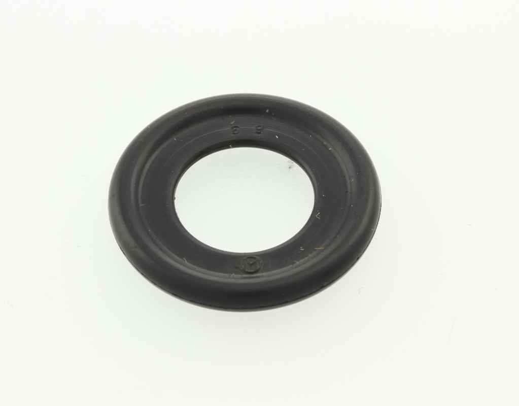

This the type you are using?
Yes. The blue/gray colored one with the square tab in the link you provided will work too. I have those in a light blue color. Sorry for the confusion. You can change that crush washer w/o draining the oil. Shop Vac Trick To Replace Drain Plug
