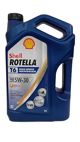

They also have a Rotella T6 multi-vehicle 5w30 which is harder to find, but has reduced zinc and is API SN certified. It is what you are "supposed" to use now for gasoline applications.

There is only one shell Rotella T6 formulation that is for gasoline engines. That is their new 5w30 Multi Vehicle oil.
