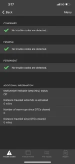

I guess you guys answered my question. I was just curious if they cleared a check engine or whatever knowing their was a code, just to turn it off so if you were to look at the vehicle and didn’t have a scan tool you wouldn’t know there was a check engine light or something else that popped up that they turned off

Yes, you are correct. I went and plugged in my Veepeak ble + into my car and it did show that information. I use OBD Fusion on my iPhone. I reset it on mine. But that is good to know

Scan for complete emission I/M monitors. If they haven't just been cleared before your arrival you're in the cream of the crop.
100% agree. If there's a service engine light I don't want the car (we have emissions testing that could be open-ended just to pass). But if you've reset just before I showed up, the I/M readiness won't be in "ready."
