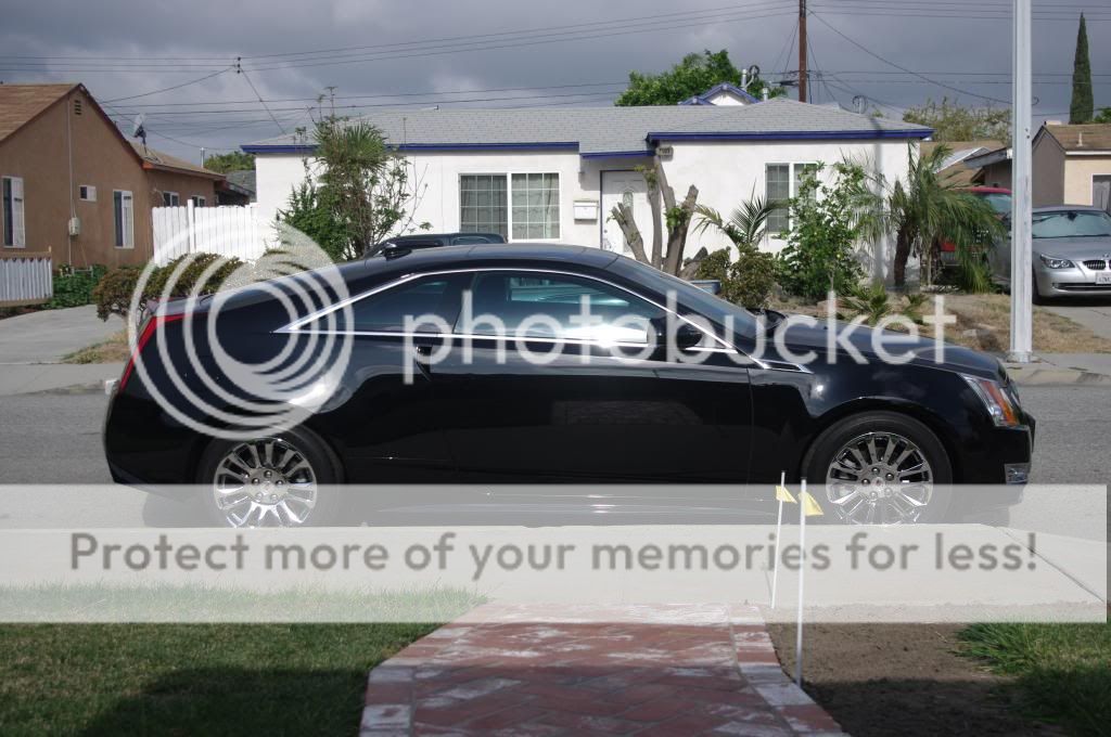

I know there's already a current post about ONR but I did want to share my experiences with rinseless washes. I just did a rinseless wash with my homemade stuff yesterday and decided my car still looks good enough to photograph to show the results.

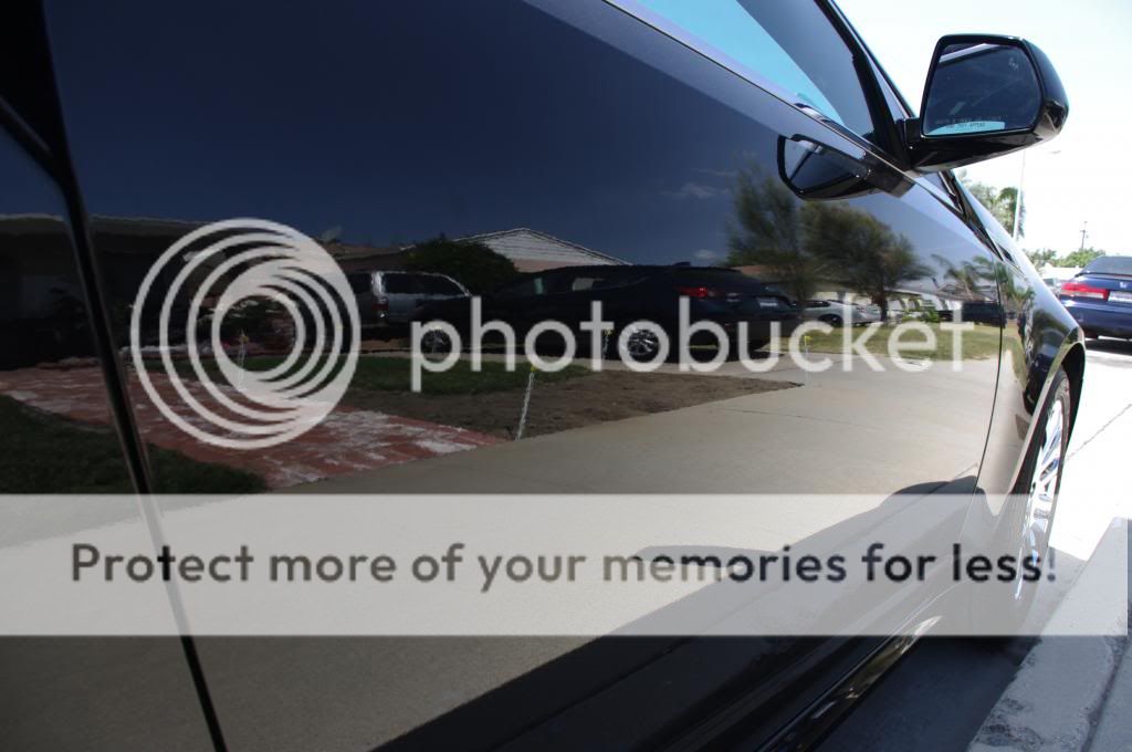

Here's just some general photos and beauty shots. The rinseless wash I make myself leaves a pretty decent just waxed finish. Really deepens the blackness of the car which in real life is apparent.
Is it perfect? Absolutely not, and I don't really mean to keep a perfect car anyways. This is a daily driver kept outdoors and it gathers dust quite a bit and quickly at that. In fact I rinseless wash it usually once a week or twice depending on how dusty it gets, if the wind picks up a lot of dust can settle, and even though other cars look decent even with just a light coat of dust it is extremely obvious on a car like mine. And I do like my car to look good.

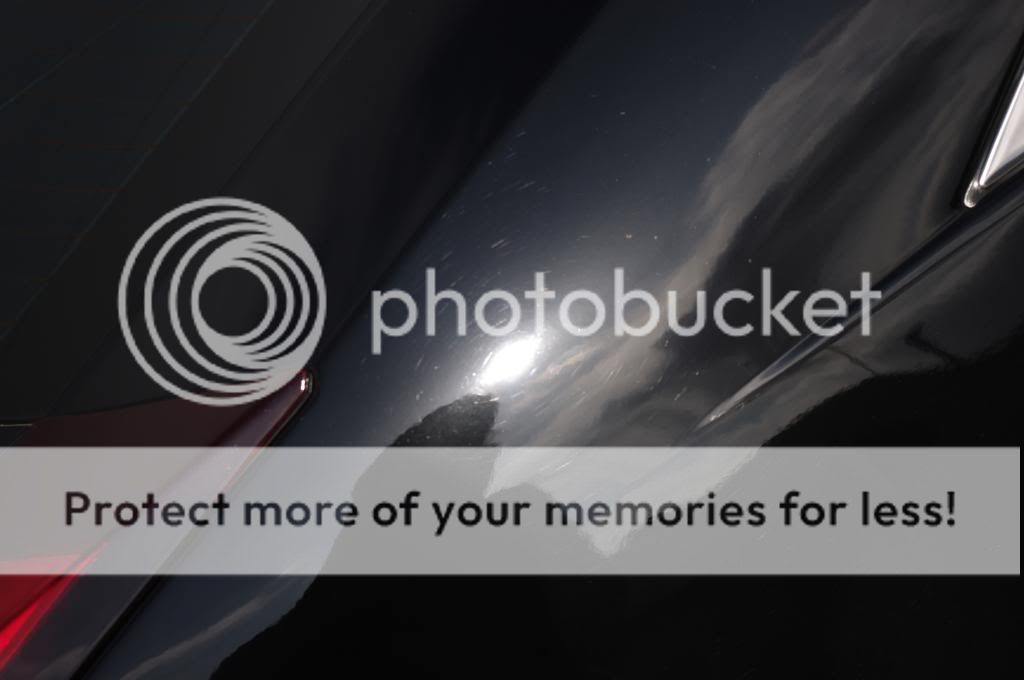

As you can see a direct sun shot reveals some light swirls. But really even when I first polished it when I got it three months ago I didn't polish it perfect, and that's on purpose. I'm trying to minimize the amount of polishing.
This is what it looked like 3 months ago after polishing. Still some swirling. So three months of nearly twice weekly rinseless washing, and monthly waxing alternating with Meguiars Liquid Ultimate Wax and Collinite 915, and with a rinseless wash I make myself didn't really inflict any more damage than a normal wash routine. And most of the swirling is reduced in appearance by the light polishing effect Ultimate Wax has.
I mean in real life the swirls are there and not really all that visible as the main shots show. Only in very specific angles and direct sun shots are they obvious but then again it was hard enough to highlight them just right to get them to photograph much at all.

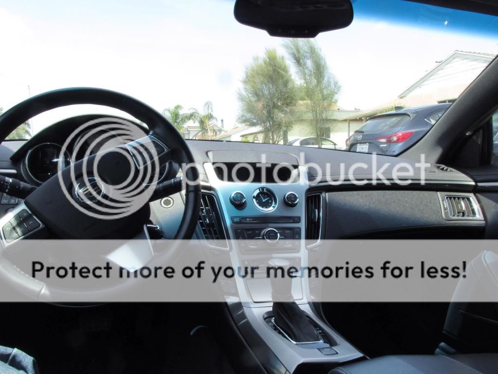

Oh and the interior. Everyone gripes about Armor All but know how to use it. Get a wet microfiber cloth, wring it out, fold it and spray the face with Armor All. It doesn't take all that much and the water helps to clean and spread the Armor All evenly. As you can see it doesn't look like a greased up mess and I can tell you it doesn't feel like it either.
After the moisture dries simply buff off the plastic for a nicely darkened plastic with a matte shine. Doing so really extends the Armor All too so you don't use as much. And the new formula does apply a little easier than the old one since it's thicker. Or you could also water down the Armor All 5 to 1 and simply apply and buff for similar results. With as concentrated as Armor All is, a little really does go a long way. And no it won't ruin your plastics. Better to apply Armor All as protection than nothing at all, all the water based protectants are pretty much the same, Meguiars, Finish 2001, Armor All, and the much ballyhooed Aerospace 303. I've used Armor All for decades. Never a problem. People who wait til their plastics start to fade and then put Armor All and it cracks, immediately blame the Armor All, not the fact that they've neglected their plastics for years and water alone would have damaged it anyways.
