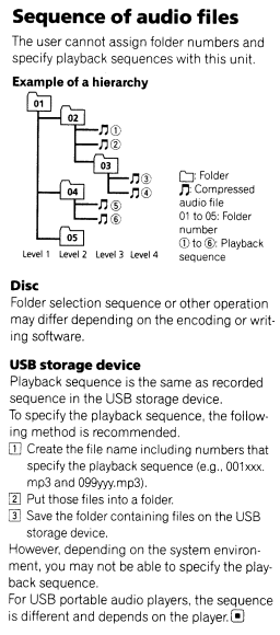

I just looked at your owner's manual. First they say that you can control the sequence by just renaming the files, but then they say that "depending on the system environment, you may not be able to specify the playback sequence." Sounds like they're trying to cover up shortcomings of their software.
Thanks, That is interesting. Maybe it would have played in the correct order if I had assigned numbers to my band/music folders instead of going by the band name. Or if maybe I had listed the folders like this:
1. Aerosmith
2. BTO
3. Cheap Trick
4. Dire Straits
And so on, all the way through ZZ Top. Maybe the Pioneer software is looking for numbered files instead of alphabetically-ordered name titles on the files. I read a lot of reviews on the 4300UB before I bought it and did not find anyone having any problems with reversed playback order. I also tested a flash drive in a similar radio at Walmart and it didn't have any reverse playback problems either.
I may take your advice and contact Pioneer to see what they say. Thanks for the help.
