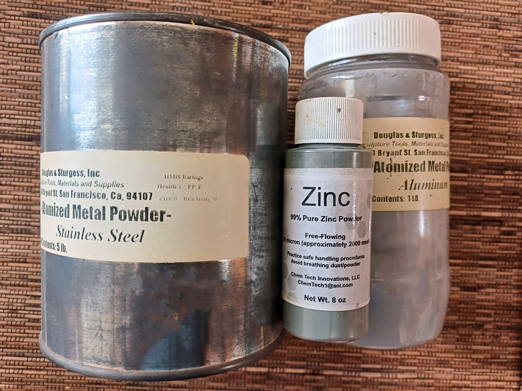

I'd make a putty out of resin and fine filings from a spare piece of Trex. I'd use 80 grit or finer sandpaper for a good result. Fill the holes, let cure, then sand flush. I use the homemade putty approach with many materials, including wood, plastic, and metal. For making metal putty I have powdered metals on hand. Use the same material you are repairing mixed with clear resin. You don't need much resin to make a putty. The color will be a close match.
