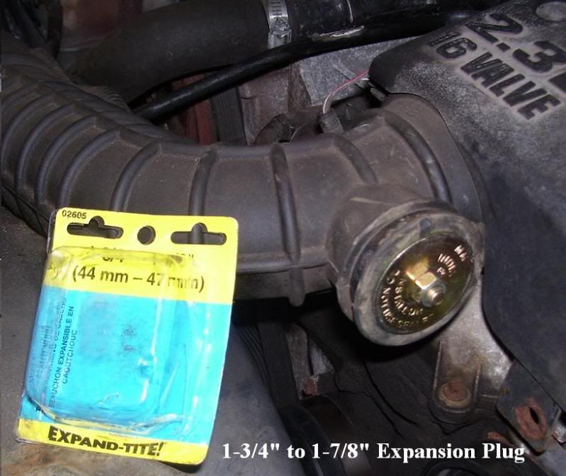

It can't hurt to play around with it. Just get the right-sized plug for it.

The auto parts store sells these rubber plugs to replace core plugs (commonly known as freeze plugs). They rubber plugs come in various sizes and have a nut to tighten them. I have used them to plug intake resonator openings. Here is the setup I had on the Ranger:
