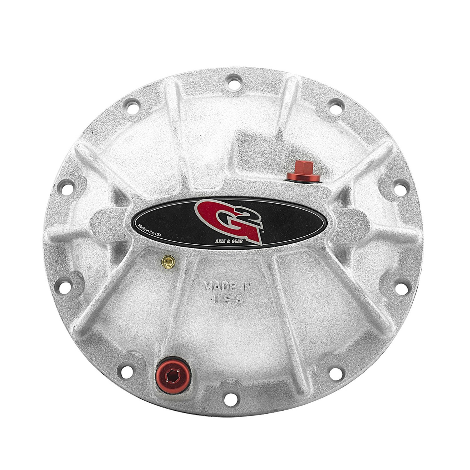

The G2 normally has a “tattle tell” port (in addition to drain and fill plugs) …
There since the capacity goes up a bit … you can still get the oil level to the bottom of axle tubes …

Yes … If you go homemade … be careful how you read this … target is this picture:
See ports on G2

Thanks 4WD i like the look of that cover , has drain as well as fill ports!
The fill port on that cover though looks higher that the illustration on oil level.
There is a small set screw, perhaps thats a plug for oil level?

BTW I like that G2 cover, I never used one but it appears well done.
Yes … that’s the little “tattle tell port” … with the truck level just fill with gear oil until that weeps a bit … done …
With that vertical fill cap … I can squeeze oil in from the bottle … check level … and used a clear straw to pull a bit of oil out …

With a machined on machined face … they seal very well … you will need to figure on longer bolts …
Take the cover to the parts house with one of your old bolts (with pattern)
On my small truck (G80 locker) it added one quart to fill …
