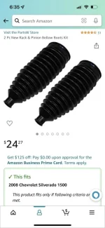

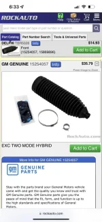

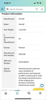

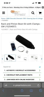

I’ve ordered rack and pinion boots/bellows from three different places: Amazon (PartsW —> horrible customer service, stay away from this 3rd party seller!), Rockauto, and now Autozone.
None of them have given me the correct part for my truck. The opening on the bellow that goes over the steering rack has been much smaller on the parts I have purchased than the one that came off of the vehicle. (See photos). And I even after striking out on the Amazon ones opted to spend the money on the AC Delcos from RA which was another hit and a miss.

The only problem is those sites sort to the same ACDelco part number that RA shipped me, which doesn’t fit. And the ACDelco boots were plastic, not rubber. So….?
I am completely amiss as to why this truck has a larger mounting diameter for the boot on the rack. What’s even more hilarious is that the AC Delco boots say they fit a 2.62 diameter rack which is simply not true because the opening on the boot which is plastic is only about 2 inches.
