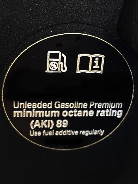

Please, interpret this label
Oct 31, 2017
13,975
I would like to know how you were to interpret this label if you didn't know anything about AKI and how it relates to the Octane rating. Would this label make you think Octane and AKI were the same? Would you wonder why the label says to use premium gas and apparently equates that with 89 Octane?
Would you wonder why they didn't write premium gasoline minimum rating 91 Octane (AKI 89) on the label?
I read it as "you should use premium gasoline" (but if you don't, then at least use 89, but don't use 87)...
A clunky way to phrase that, but that may be one way to interpret it? AKI 89 is midgrade, not premium, in most of the US (not sure about other parts of the world, though). Basically - it might mean "premium preferred, mid grade required"?
To me, I would simply interpret it as use 89 or better.
Here we have 87, 89, 91, and 93. In this instance, stay away from the 87 but use any of the others.
Pretty much the same label that was on my BMW except for the part about additives. In the context of that statement anything 89 and above is going to be a premium product.

The manual clearly states:
Recommended gasoline grades:
The manufacturer of your Mini recommends AKI 91
Minimum grade: The manufacturer of your Mini recommends AKI 89
So Premium is recommended, Plus is okay.
I was just wondering how you guys would interpret the label, which in my opinion is poorly worded. I think it would be better if were to say:
Premium gas (AKI 91) recommended
Mid-Grade gas (AKI 88) required
