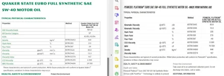

You're right about QS Euro and PPE being the same, at least in manufacturer-published documents.
The only discrepancy between the two is a slight difference in pour point -39 QS vs -40 PPE
This may indicated higher GTL content in PPE?
Current PPE is -45.

To split hairs and continue in the BITOG fashion, the link off the Canadian site is here, published 5/25/2020 showing -40
https://www.shell-livedocs.com/data/published/en-CA/df7eb22f-6592-4a89-b759-422b4b5dbce0.pdf
Your is published 5/14/2020 (older) showing -45
I suspect that yours is a typo since all of the other values are identical, not that it matters that much!
Cheers
It is Pennzoil. They are known to list 0W20 numbers in 5W30 pds (or it was vice versa, can’t remember).
