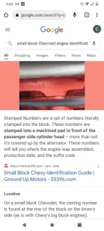

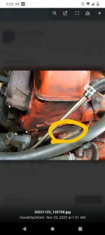

Perfect. It still has the 283 heads. Now there is a pad I circled. There will be numbers and letters on it stamped into the block. The numbers will match the vin if it's the original engine to the truck. There will also be a letter or letters like an "E" or "AA" etc... What is it? If you can post all you find that will tell us more.

Alright there are some numbers on the right side that start with F. No numbers to the left of that like the photo above. I need to clean it better tomorrow and check. A wet paper towel didn't clean it that well. No E or double A either?
The number and letter combination does not match anything from the VIN.

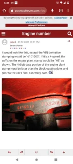

It could be any letter I just used those as an example. See how in this pic there is an "HE" on the right? Look there.
