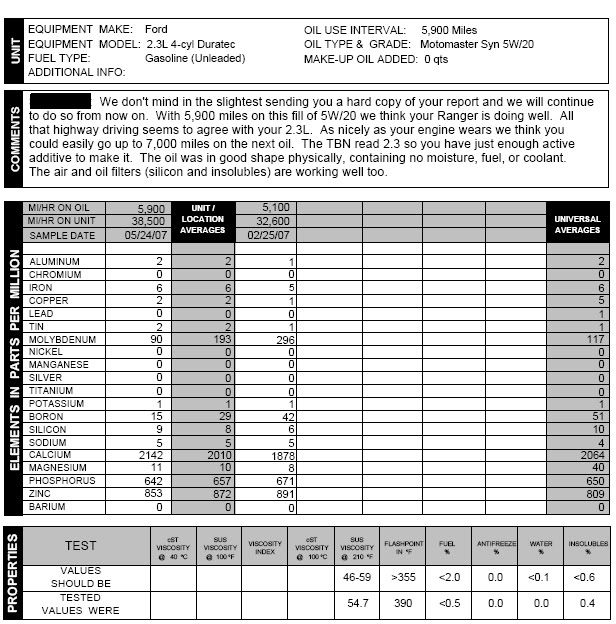

Hello
This oil was in use for 3 months and 5900miles. I did about 75% highway driving with the occasional hour long high speed run. Air filter was a motomaster made by fram and the oil filter was a quakerstate made by purolator. This is the Canadian Tire house brand oil in the fancy looking gold bottles.
This oil seems to have a slightly weaker add pack than the tech 2000 synthetic (my last uoa). Wear increased a tad but nothing major. I will say that I am not impressed with this purolator filter. It was bad enough that I had to clean all kinds of junk off the threads but it also gave me a solids of 0.4. The cheapo motomaster fram on my last oci did better. This filter also gave me a scare when I fired up the truck after getting gas and it read no oil pressure for a few seconds. Oh well, can't complain I suppose. That will be it for UOA's for awhile. I have switched back to dino for some 5k runs.
Thanks very much for that - like many, I've been curious about whats in the 'house brand' syn's for a while.
As to which is better, this is a bit of a tough call - T2000 has way more moly, but the MM has more calcium, and still has a decent amount of moly....UNLESS its left over from the T2000...still, wear is good!
You don't have any wear. I'd say that your mileage is limited by the buffering of the oil. Great numbers.

2003 Ford Ranger 2.3 duratec
Motomaster 5w20 synthetic
Blackstone comments - "With 5900 miles on this fill of 5w/20 we think your ranger is doing well. All that highway driving seems to agree with your 2.3L. As nicely as your engine wears we think you could easily go up to 7000 miles on the next oil. The TBN read 2.3 so you have just enough active additive to make it. The oil was in good shape physically, containing no moisture, fuel or coolant. The air and oil filters are working well too."
Mototmaster Tech 2000
5w20 syn 5w30 syn
Total miles 38500 32600
OCI 5900 5100
Date 2007-05-24 2007-02-25
Aluminum 2 1
Chromium 0 0
Iron 6 5
Copper 2 1
Lead 0 0
Tin 2 1
Molybdenum 90 296
Nickel 0 0
Manganese 0 0
Silver 0 0
Titanium 0 0
Potassium 1 1
Boron 15 42
Silicon 9 6
Sodium 5 5
Calcium 2142 1878
Magnesium 11 8
Phosphorus 642 671
Zinc 853 891
Barium 0 0
SUS @210F 54.7 54.7
Flashpoint 390 385
Fuel 0.5 0.5
Antifreeze 0 0
Water 0 0
Solids 0.4 0.3
