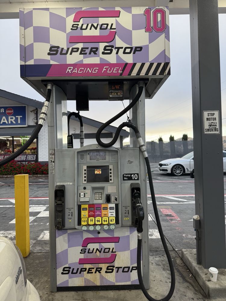

0There’s 100+ AKI street legal unleaded race gas. I heard it’s dyed blue and some call it Smurf gas. I think that’s what this place has, where they use a blending pump for anything higher than 91. Not sure why 94, as the typical requirement is 93.
I looked it up, and there are several places in Wheatland that sell Sunoco 100 octane. They definitely have the sign, although I’m not sure how they sell it.
