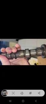

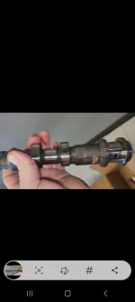

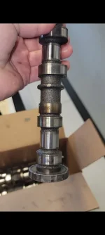

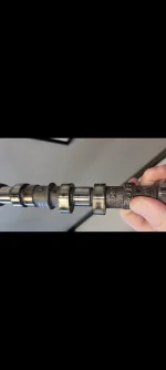

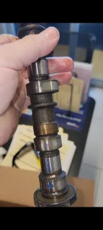

I can only confirm what the dealer has said. I was there Monday and the tech wasn't in-of coarse. My service advisor I've been working with since day 1 back in 2015 and has been extremely helpful and on the up and up. She represented the piece as metal and listed it as the main reason for the engine replacement. I'd be pretty upset if the tech doesn't know the difference between a plastic piece and metal. I ll email them or go down there again to verify. Thanks

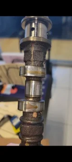

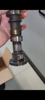

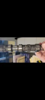

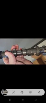

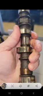

Here are the cams from repair from med October not sure if that helps. Dealer is getting with tech to confirm that that big thing is metal which is scary since she represented it as metal for the past 2 weeks. Ill keep ya posted.

The cams were worn pretty bad so the concern was metal chunks in the lower end
