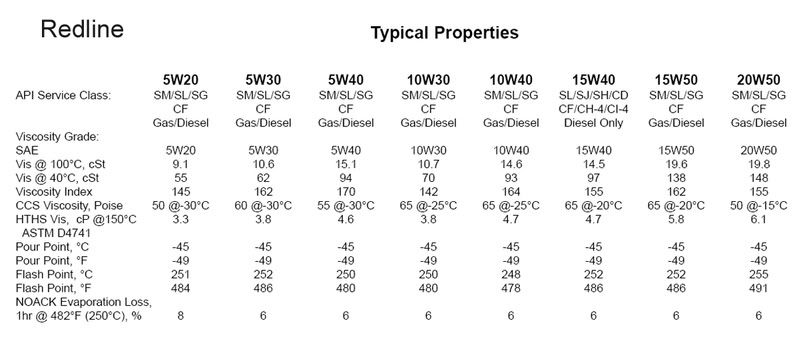

Mckay,
I would defer to Pablo, Buster, and others who know a lot more about the right viscosities to use. The 5W30 sounds pretty darn good to me and amsoil or redline 10W30 also.
Perhaps Pablo, Buster, or others can shed some light on whether anything in the following specs might suggest which weight might work well for this turbo assuming startup "pumpability" is important as well as holding up to high temps/stress:
