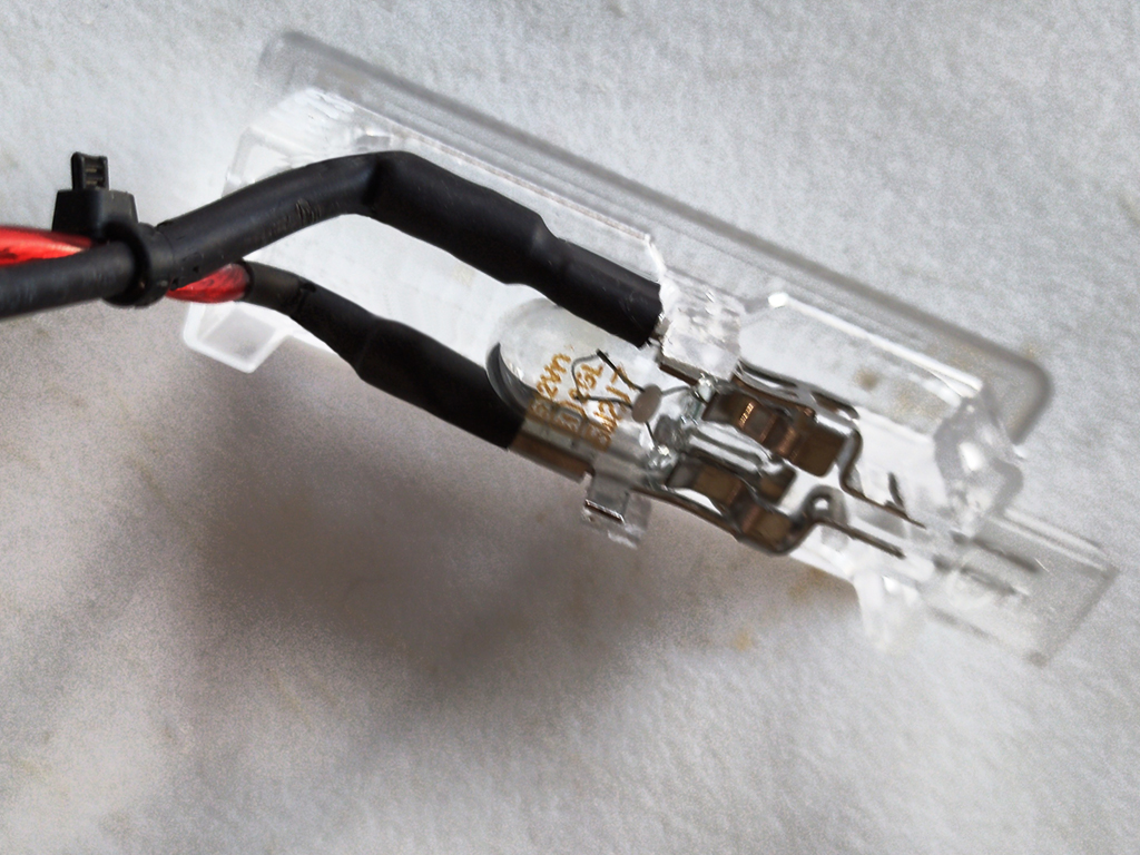

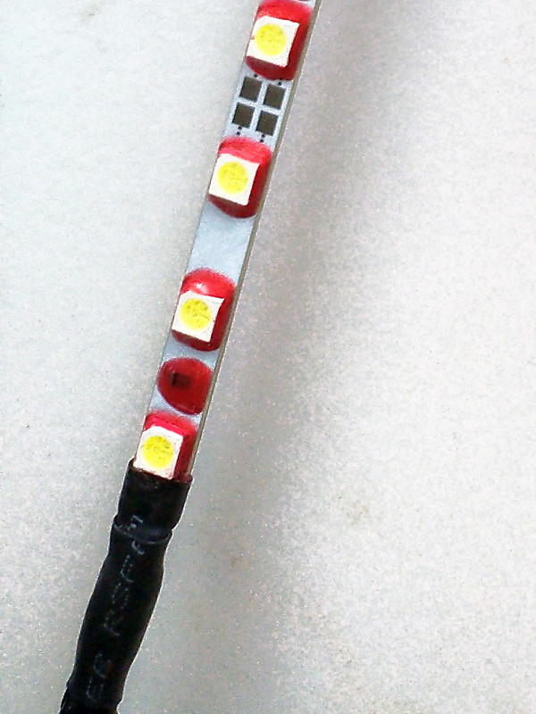

The Mini comes with only one small incandescent bulb as trunk light. Even a super-bright LED replacement would not have been sufficient for proper lighting. I installed an 18 (3-chip) 5050 SMD LED strip light. I weatherproofed the strip light with resin that I dyed red so I could tell where I had applied the resin. I used 0.75mm² (18-19 AWG) copper wires, braided nylon sleeves to protect the wires, shrink tubing, spade connectors, an inline fuse holder (2A), I crimped and soldered the spade connectors. I could modify the OE trunk light to tap into positive and negative. Nice and bright.
