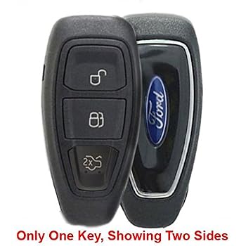

now i just need to figure out how to get the bloody thing open to the point can change the battery.. ( I can get the back off to get to the actual KEY blade, but ventured no further for fear of breaking it..)
one of these:
one of these:
[Linked Image]
Ooo those are no fun. Let me try to make a video of how to open them up. You take a little pocket screwdriver and put it up at the point end and twist. I'll try to get one for tomorrow.
Thanks for offering to make a video, but that description actually worked a treat..(I also hit up youtube) but got the battery out, tested @3.05v on my multimeter...so hopefully I SHOULD be good for a while? (I'm Gonna Assume the Dealership changed the batts in the pre-delivery inspection/repair/etc.....my brain says they probably didn't, but i'm gonna assume they did anyway..the did change the oil, air filter, and brakes after all...)
Usually new voltage on a CR2032/CR2025 is about 3.30 volts. At 3.06 I get a low battery warranty message.
