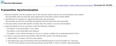

Perform the synchronization procedure. Refer to Transmitter Synchronization.
Did the locks cycle and the park lamps flash?​
Go to Step 12
Go to Step 13

Compare the directions you have with the actual GM directions:
