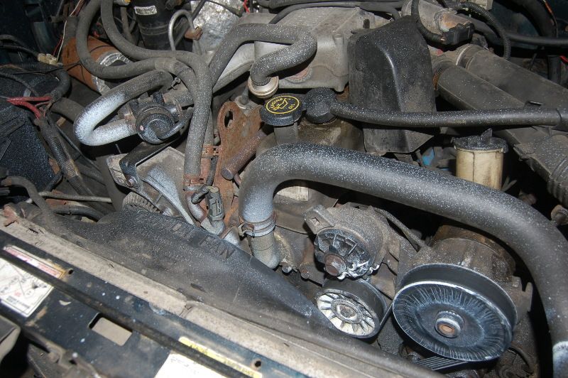

Seller was a regular joe, he lived on a cliff and slipped on some ice, wrecking his shoulder, and he can't drive stick. Traded cars with his wife, she got sick of this truck, mostly because the belt tensioner seized and was making a horrendous racket.
His solution was to spray white lithium grease on the offending bearing; this cleared up the noise for 1/2 second so I could hear the motor (his words.)

This is the spray from the lithium grease. I replaced the bearing with... TL;DR... a used 6203 bearing from a saturn alternator. Said alternator was making noise so I got a new bearing for *that* which helped nothing. Turns out the (saturn alt) pulley was warped and chriping on the belt so I just threw a different alternator in. ANYWAY, I don't ever throw anything out and these 6203 bearings are all over the automotive world.
^ PS, sharp-eyed Bob-ers might notice the AC compressor is a few inches back and not part of the belt drive. There's a way of rigging the mounting bolts to put it "on standby". This was a PO hack-- I had nothing to do with it.

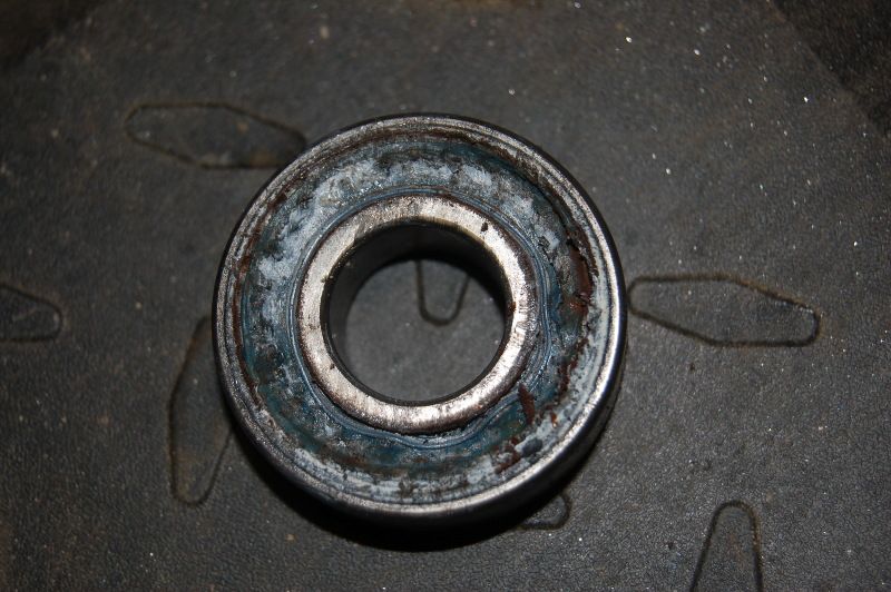

The offending bearing was seized and likely just spinning on its bolt:

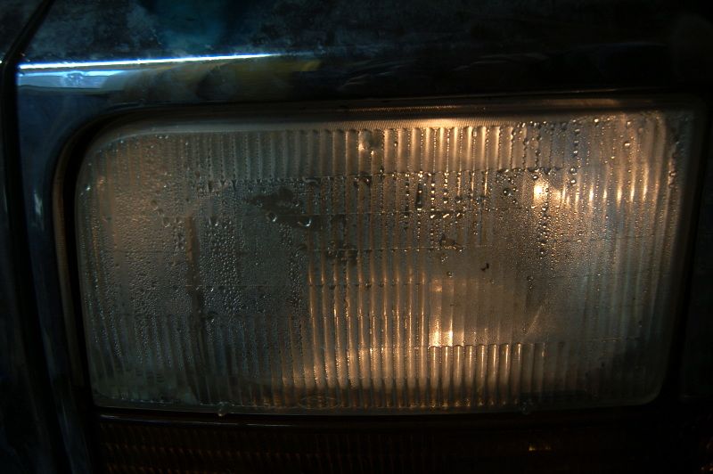

By the way- the bulb shouldn't have made a "pop" noise. That says that the air vent tube(s) are plugged, which is why the headlamp is accumulating condensation.

Feh, these xmas lights aren't working so I drilled a couple vent holes, put a 6 amp battery charger on and turned on the high-beams.
I had to drill some holes in the headlight of an old Ranger I used to have, for the same reason. Turned out to be a big mistake. Everytime it rained or I drove through a puddle with the lights on, water would go through the drill holes, touch the hot bulb and the bulb would explode. I replaced the bulb 3 or 4 times and it would happen right away during rain. I finally had to replace the entire assembly ($$$).
It did look funny for awhile with the bulb remnants starting to pile up inside the headlight.

Yeah I drilled a couple 1/8" holes in the back of the reflector. Running the high beams (more power, and the dual-filament bulbs always blow the lows first) with a charger hooked up, and a computer fan blowing on the back-- near one hole, far from the other, to help air circulate.
Put a license plate on front so the infared heat energy gets reflected back into the lamp where it'll do more good. Used some of the handyman's secret weapon...
Headlight housing will clear out on its own by leaving it out on a sunny day(s), letting it bake, if it ever gets sunny and warm here. Been there, done that.

Now I have to get the moisture out of this headlight! I had poor results in the past sticking one in the oven at 200 degrees as the reflective stuff just wasn't the same. I can't fit a boot dryer in the hole, not even a night light. So... incandescent xmas lights!
BTW, the bulb made a satisfying "pop" vacuum noise when I finally finagled it out of the housing.

New tool for wiping the inside of a headlamp down...
Kinda like stealing a tampon from a vending machine.
Also... found silica gel packet inside, fished it out.
