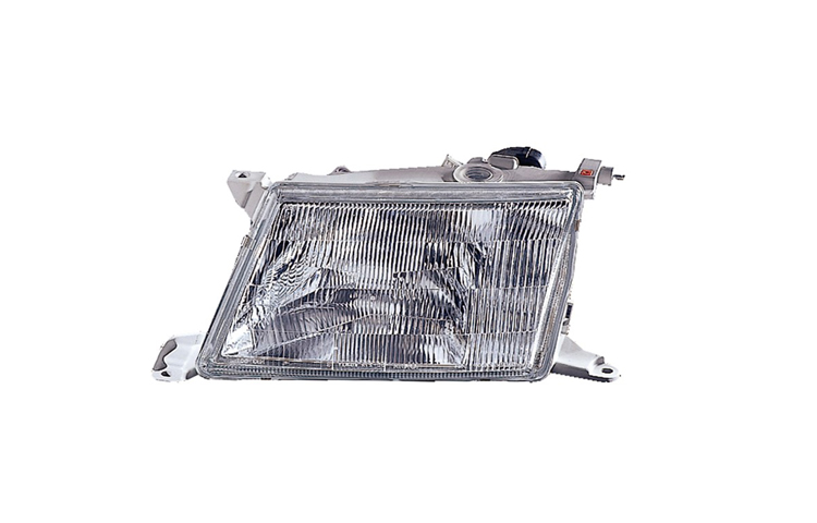

Installed the ApexClone kit.
That is the only reason why I stay away from hid kits in halogen housing. The pic above explains it all and I bet it's even worst if you are approaching. It's going to be a matter of time before someone gets hit by another car because of these hid kits. Until people put them in CORRECT retrofits...I will continue to turn my lights on bright too. What is the old saying, you get what you pay for...
The light pattern in the 2nd picture is similar to my '00 MB E430 with halogen bulbs, and this car has E-code headlights which is supposed to have good pattern, a lot less glare compares with most cars on the road.
Audi Junkie...
Only way to set this straight is to have someone drive your car, and you in another to see if there are any glare issues. (I think it will be fine!)
A little OT - I didn't think much of the lighting from my first car with its 7" rounds (35w sealed halogens). With my second vehicle with it's 9005/9006 combination in a '95 Volvo, well it's left me disappointed. Fresh bulbs and re-aiming hasn't helped much, but I think over the years I've grown to live with it. I remember the first few weeks of night driving I was a bit freaked out about the difference.
Are these lights really that much safer as compared to how "attractive" they look over the old standards? I'm still wonder from time to time about how I might tastefully convert to "old school" units. Oh well.
Couple evenings ago, I saw older Taurus (circa 2000) with HID. Surprisingly, it looked good and did not glare at all. I do not think he had retrofitted projectors in it.
- Vikas
'It doesn't look like it had glare' isn't really a quantitative conclusion. There are many more aspects to glare than 'looks'. There is beam intensity, reflection (unwanted/wanted) from many different angles at many different elevations and many other evaluative aspects involved.
More light is not always safer. Whiter light doesn't mean brighter light. Correct lighting is putting the light where it is supposed to be without going anywhere its not.
Rest assured any HID bulb in a meant for halogen enclosure will produce glare and is not safe.
If your headlamps are not adequate do to age/deterioration then consider getting aux driving lamps from a reputable company with proper design ie, Hella, Cibie...(PIAA is trash.) and use when safe and needed.

I'll be the final judge of the lighting I installed in MY car.
So far, not a single flashback and the look perfect, from MY perspective, which is what matters.
I would like to believe you but unfortunately, there are rules and regulations in the world which controls many things (sometimes too many things).
- Vikas
That is about as selfish as one can get.
Trust me your arrogant outlook only solidifies my point that you have zero concern for the well being of other drivers.
Your car came with a halogen reflector housing and was in no way designed for HID's. Everyone and their mother can claim the cutoff is really good for a reflector. You are just using false reasoning to justify your idiocy.
Good luck with breaking DOT laws.
If your perspective is looking at your car from 50 feet away, remember that it's not the same as that of oncoming traffic. Try this experiment,if you haven't already done so. Swap cars with a friend, drive a mile apart on an unlit two lane road and see what it looks like. If there really is no glare, then you've done a good job. A photo of the lights shining against a wall showing a sharp cutoff would also help to quiet the disbelievers, of which, I must admit, I am one.
I want to do this on my motorcycle.
Interesting thread title. I'm pretty sure it's Apexcone.com. As in, when you do a track day, the instructors put a cone at the inside apex of of the corners until the newcomers learn the track. I think this is a website started by (or associated with) a guy named Jim Powell, a bmw enthusiast who has also posted a number of good bmw related DIYs on the web.
Thanks for the 411 to all on this kit. I installed on H-4 lamps and they are great. I got the dual filament option with 35watt bulbs. I aimed the lamps on the road and I must say it helps overall vs. higher wattage bulbs. I do worry about one thing and that is the ballast.
They generally fail within a year. I heard some testimony that they last longer but, that is a major issue with durability with all retro kits in general. I will probably buy a set for 9006/9005 also.
