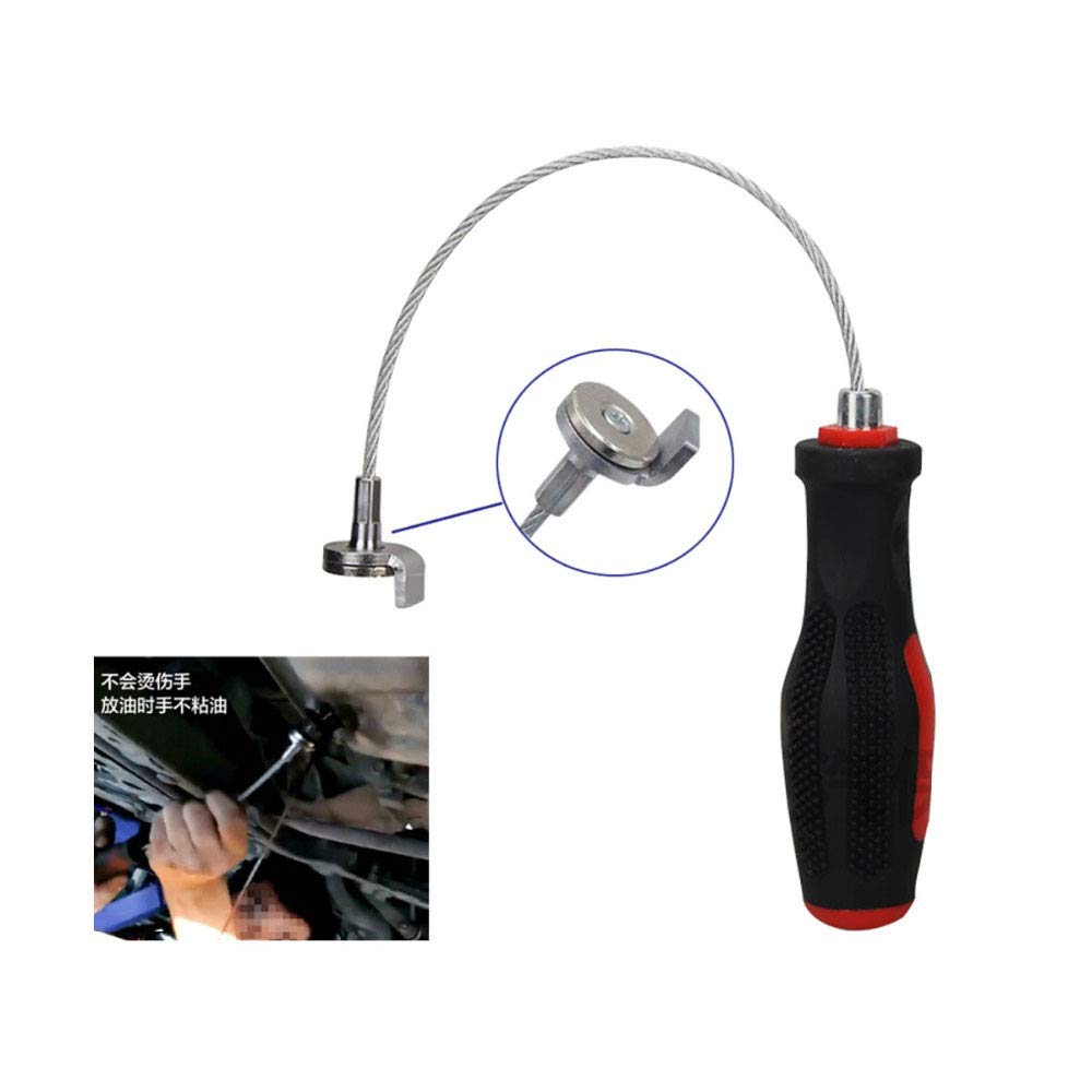

I've used a magnetic drain plug remover like this for years and don't get a drop of oil on me.
[Linked Image from images-na.ssl-images-amazon.com]
