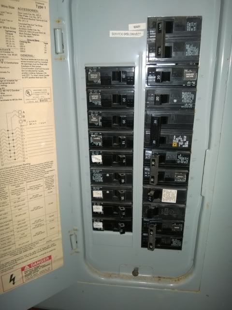

Here's a photo from the home inspection. Notice the two disconnected wires. Those are the hot wires for the dryer circuit breaker. And, the folks who ran the A/C line used the (excess capacity) dryer breaker instead of putting in a 25-amp breaker:
Here's a photo of the panel currently. I moved the breaker for the stove down to the bottom (occupying the two open slots on the left in the picture above), the A/C has a correct 25-amp breaker, and the dryer breaker is under the A/C breaker (and now powering the dryer):
More through dumb luck, only having slots open on a single side of the panel, and needing to put breakers where the wiring was than anything else, I believe have the panel in the order it should have been in all along. The two single breakers I disconnected went right back into the slots they came out of, and running the wires they originally did. There was no way around that due to the wire lengths, thankfully!
There aren't any tandem breakers or anything fancy in there. From my limited understanding, a double breaker that spans both busses should keep the panel in balance since it's drawing from both busses. Applying to my case, putting the single breakers back where they came and powering what they powered while adding a double breaker shouldn't disrupt the amp balance between the busses since the new breaker is drawing from both. Am I correct?
With that new information, did I unwittingly do exactly what was supposed to happen, or is this pooch still hosed?
A double breaker draws from both legs of 220V. Unless you went out of your way to put single pole breakers only on one leg of 220V you should be OK with balance of the box. Given random use of electricity in various rooms.
I didn't do that. The limited space I had forced my hand in where things went. The two single breakers I disturbed went back where they came from.
Looks like I'm in the clear. Thanks for your help!
