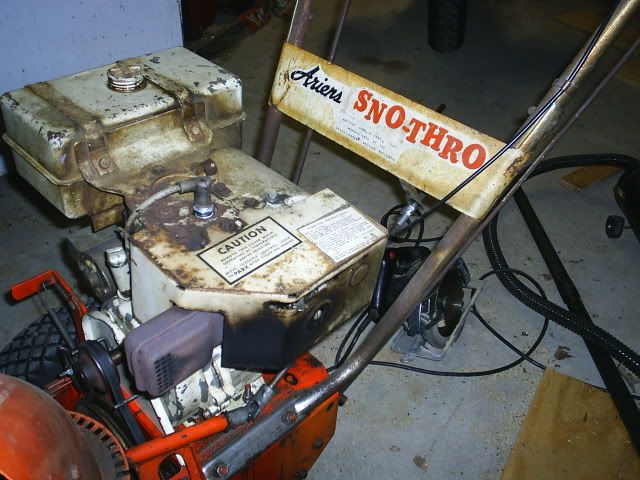

Got this ariens snowblower
Jun 15, 2003
42,523
ME
Itchy to use my stash of five spare Chonda 6.5s. Got this thing wicked cheap, no spark.

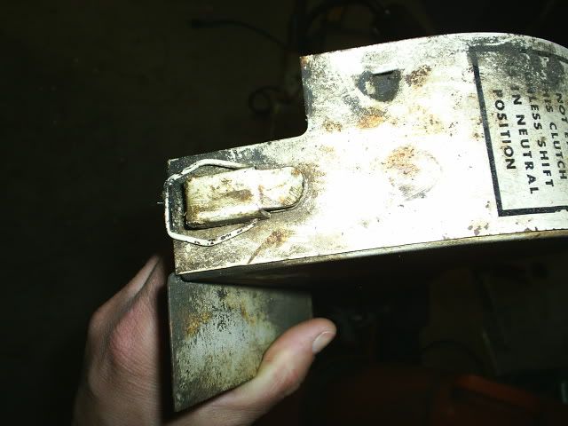

Want to look at the belt? The guard has lunch box style quick releases!
But wait, take two thumbscrews out and the whole blower part falls off the front of the "tractor". This is the PTO joint:
Maybe this could have been the rear end of some other groovy stuff, like a brush hog...
Non original (says seller) tec motor with electric start:

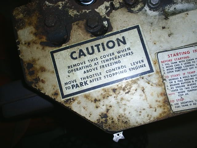

This is cool, take the heat shield off for summer use: PS, takes 5w20 winter, MS grade 30 in the summer.
You can't shift gears without pushing down on that lock button.
PS, Oh joy, the motor has a 3/4 shaft just like the chonda. Saves me buying a new pulley. Neutral on the wheel drive is a true neutral, this thing rolls very lightly. Most blowers have substantial drag. This might be a keeper, leading me to dump my toro! Just have to wait 6 months to see...
