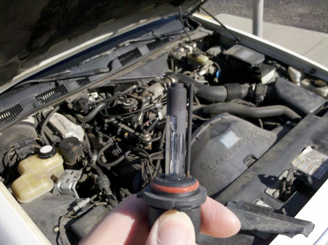

I installed a DDM Raptor V2 9006 HID kit in my 96 Crown Vic, and the output is extremely impressive. The problem is that I was getting flashed pretty often; especially on the interstate. Standing in front of the car it was pretty obvious that at certain angles there was tremendous glare. The way my headlight lens is deigned, there is a square dead center in the lens that spreads out the light, and then to either side of that there are parts that don't have as much of the fresnel type lensing effect (http://monsterautoparts.com/FORD/CROWN VIC/_CROWN VIC IMAGES/3221-0013R.jpg the left side is the low beam, right side is high beam). Those smoother areas allowed oncoming drivers a straight in view at the HID bulb, and it was very blinding. My solution was to paint the tip of the bulb with some high temperature spray paint (found at Lowes, resists heat up to 2000F). I painted from the top of the oval capsule all the way up the tip. That made a dramatic difference, but it still wasn't quite enough. I noticed that the bottom of the reflector was still throwing enough light at oncoming drivers to blind them. I took the bulbs out and painted a band under the length of the oval arc capsule, half way up the side of the bulb. That has eliminated nearly all of the glare, and I have yet to be flashed a single time since this modification. Light output is somewhat reduced, but not by much. I've even re-aimed my beams, raising them by about 6" at 25 feet because they were aimed for police use, with heavy equipment in the trunk. Still no flashes.
Yes I am aware that there are some bubbles in the paint. I experimented using the drivers side headlamp, doing one light coat at a time, and adding more as I changed the shape. I was letting the paint flash, then connecting the bulb and letting it smoke before putting it in the housing, because that smoke would have messed the reflector up. Once I had the shape down, I did the passenger side bulb all in one whack, and it got several coats at once. When I cooked the paint off, it bubbled. The bulb has a dozen hours on it since I painted it, and there are no signs of the paint actually coming off. The paint used was Rustoleum High Heat.

Actually it is cool that you are experimenting to benefit the rest of us. BTW, I believe someone noted, may have been this tread, that an hid vender sells hid bulbs with "shields".
I saw those shields, but in my case they would not have been enough. With just the tip covered, you would still be able to look through those "windows" in my headlight lenses, straight at the arc.
