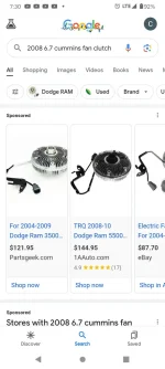

Many mechanical fan clutches are electronically controlled. First I remember was the 2003 6.0 power stroke in a ford pickup as do the 2004+ dodge with a 6.7 Cummins . Those 2 always failed. See the wires?

That's new to me. What happens inside when they power up? Doesn't look like an a/c clutch.
