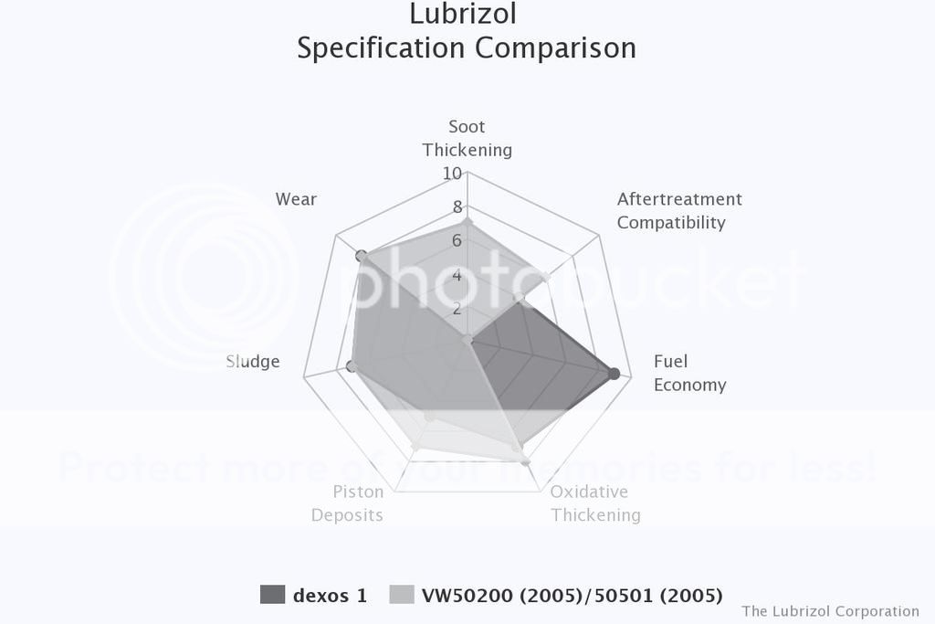

That uniformity time is past. Each design has its flaws and advantages. Dexos 1 is less focused in piston deposits than several other specs. Even a vw 501 and 502 are better in the cleanliness aspect. But in fuel economy is the other way around...
Not the best long drain oil, imo.

vw is 7 and dexos is 5 out of 10. IMO both protect against deposits.
