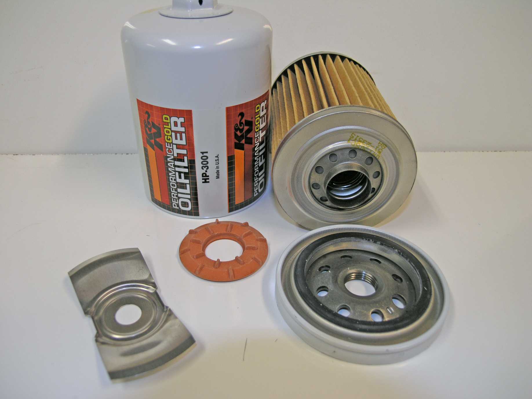

This is a K&N HP series (white can + nut), made in USA by Champion. It was in service on a 1999 Corolla for about 9 months. Unsure of mileage, but I'll put it somewhere around 4000 mi.
Like other Champ filters, the base plate is quite heavy (I had to use a screwdriver to pry it out once the can was cut). It uses a coil spring bypass valve and the silicon ADBV felt fine:
Closeup of the workings of the bypass coil spring + blue plastic mechanism:
Pleats were mostly well spaced, and no tears found. Couldn't find the seam where the paper was closed either. This was the only spot where they were uneven:
More nice looking pleats:
David recently posted a cut open HP-1004 in this forum as well. Unlike him, I don't think the can was weak or too flexible, the whole thing felt very well built. Probably won't use another one though because of cost (this one came from the AAP PP+K&N deal last year).
