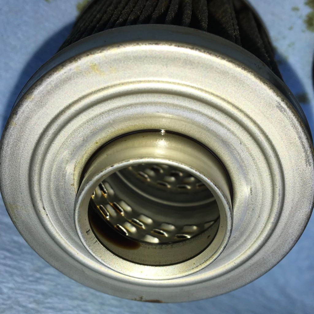

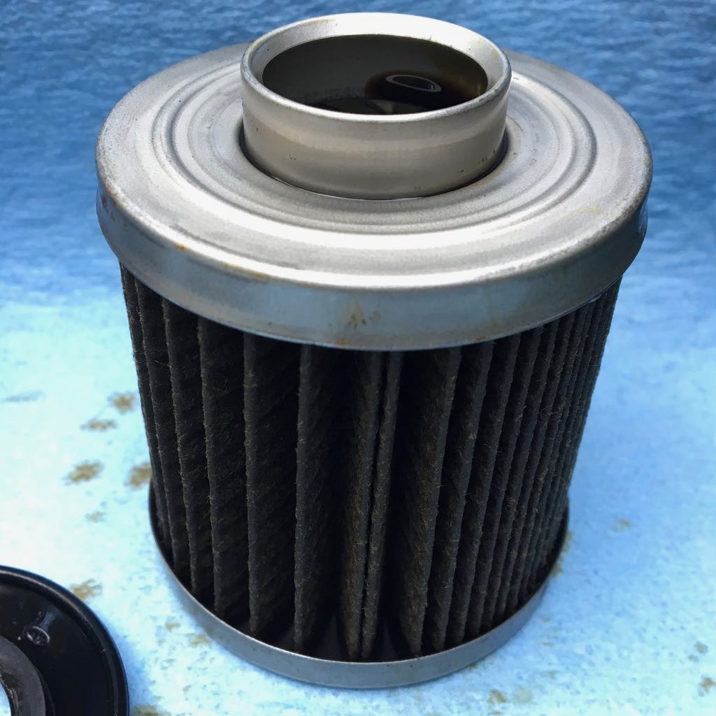

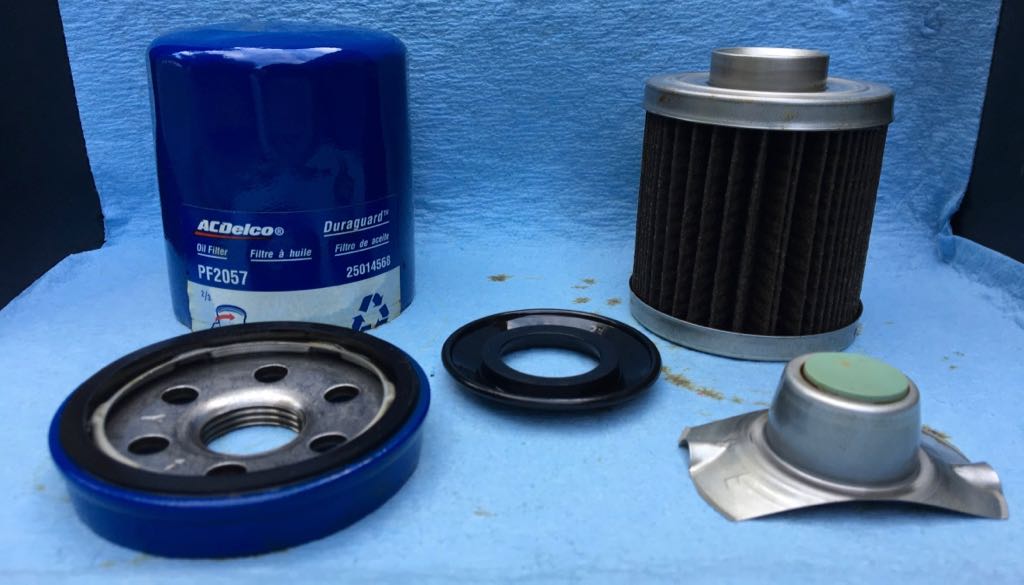

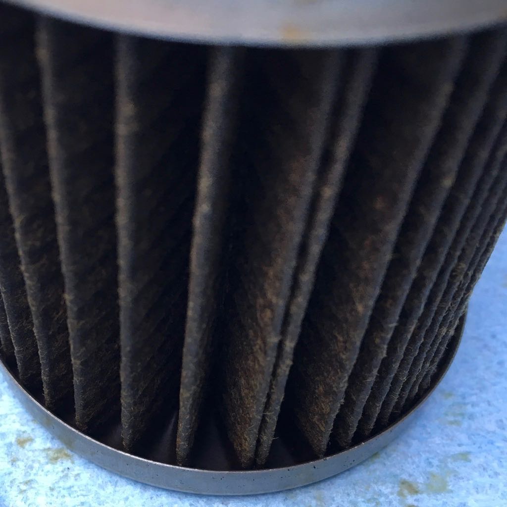

The only thing I did not really like about this one was the nitrile ADBV. It seemed a bit stiff already and the engine did seem noisier on it.
I don’t necessarily disagree with using OES filters. Though with the exception of Motorcraft I try to avoid Purolator made filters and a lot of them are made by Purolator.
In reality, since Fram has gone to Silicone ADBV across the line, where spin on filters are concerned there is little reason to look elsewhere.
