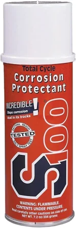

S100 16300A Total Cycle Corrosion Protectant Aerosol - 7.2 oz.​
Anything is better than nothing.
