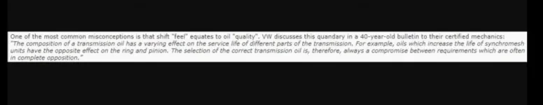

Having said the above - I do know that AW formulations certainly contribute to wear protection, as does (I believe) viscosity.
Sorry about the type-size of this attachment (turn your mobile devices side-ways), and for having posted it some considerable while ago... but I believe the principle is an accurate one.
