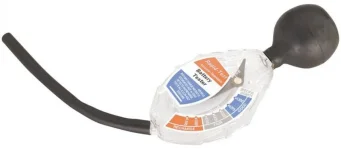

These testers look the same except for the sticker.
Are they calibrated the same though?

I am sure they are calibrated differently. How would you interperate the scale anyway?
No completely different. You have to have two different ones, one for antifreeze, one for the battery.
Yes a refractometer will work as long as the scales overlap. But this density tester? Even if it did how would you know the results since the labels are different?
He asks if are they the same except for the sticker, but the sticker is what tells you the result.
If the needle is in the middle you are good
