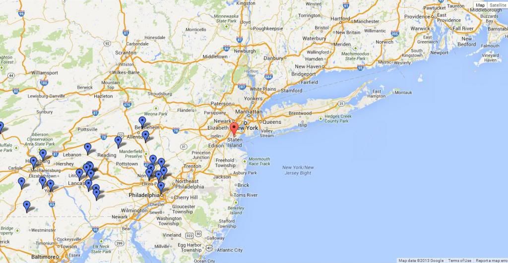

Looks like there is 241 stations in NYC that sell non-oxygenated fuel. It is all I use in my sm engines. It is aproximatly $.45 higher than ethanol blend here. I use regular Stabil for off season storage.
The nearest Non E fuel is in Philly...
Grr...
