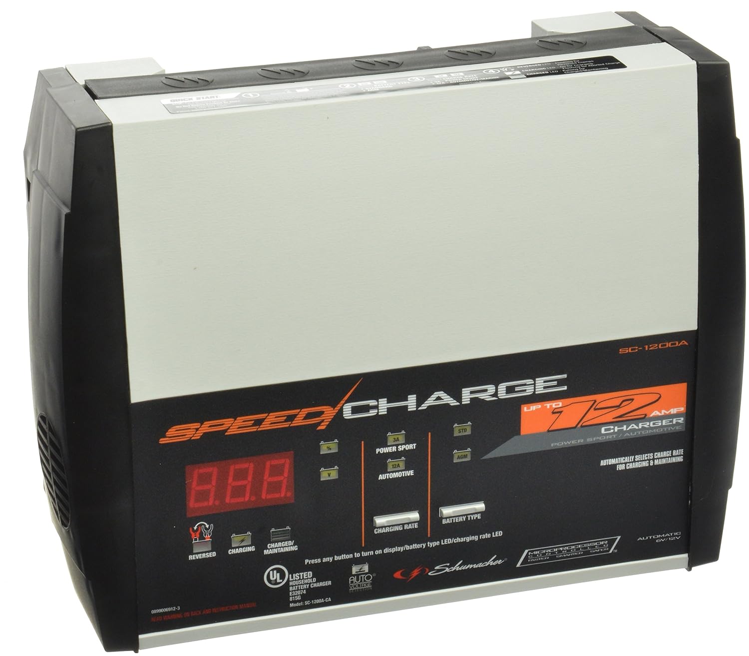

Son has the Advance Auto version of the Schumacher SEM-1562A-CA 1.5 Amp Speed Charge Battery Maintainer. Same charger just labeled Autocraft Charger/Maintainer. Used it this past weekend to charge an Audi OEM battery, said it took ~12hrs to get the fully charged green light. First time the battery had been charged, but was having no starting/cranking issues. In my experience with low amp slow charge maintainer (like Battery Tender Jr) didn't seem out of the ordinary.
Reading the charger/maintainer literature I noticed this in the instructions. "The Schumacher SEM-1562A is a battery maintainer, and maintains both 6 and 12 volt batteries, keeping them at full charge. It can charge small batteries and maintain both small and large batteries. If you are maintaining a fully charged large battery, you will be properly utilizing the battery charger. However, if you use the battery charger to charge a large battery, such as a marine deep cycle battery, that was not fully charged, you may lose some of the battery’s capacity. This would cause the large battery to be unable to hold a charge and become useless. Therefore, we do not recommend charging a large battery with this unit." It does however show a desulfation mode.
So the question is, can using this charger/maintainer (or any low amp charger/maintainer) actually reduce the battery capacity or life, specifically of a not fully charged but not dead auto battery?
Below are links to the Schumacher Charger on Amazon and the pdf instructions. You may notice the charge chart on Amazon differs from the instructions. Larger batteries show 'maintain' in pdf.
What say you battery charger experts?
