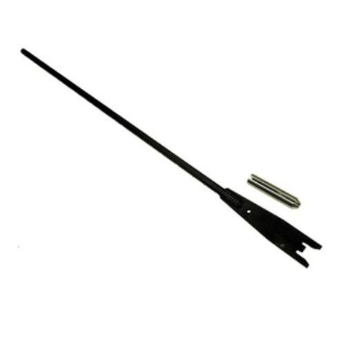

This is the gm tool for stuck tires. A super long screw driver is less.
https://www.amazon.com/STUCK-SPARE-TIRE-RELEASE-THX-805/dp/B00YTNFGG2
