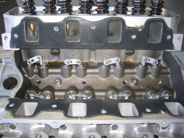

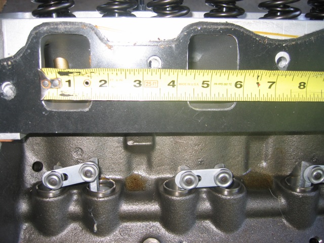

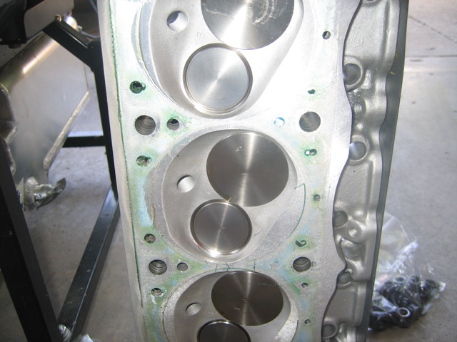

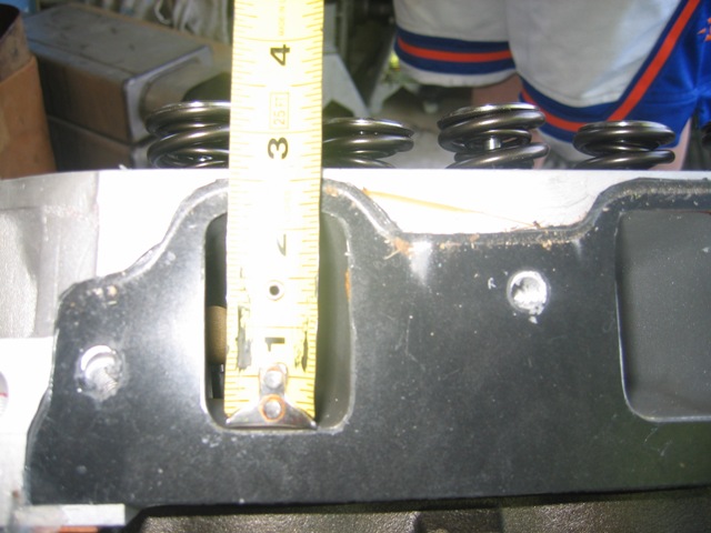

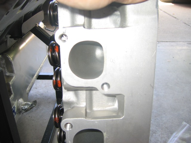

However, these are a set of ported BOSS 302 heads belonging to Jay Allen of Camshaft Innovations:
These flow OVER 400CFM.
